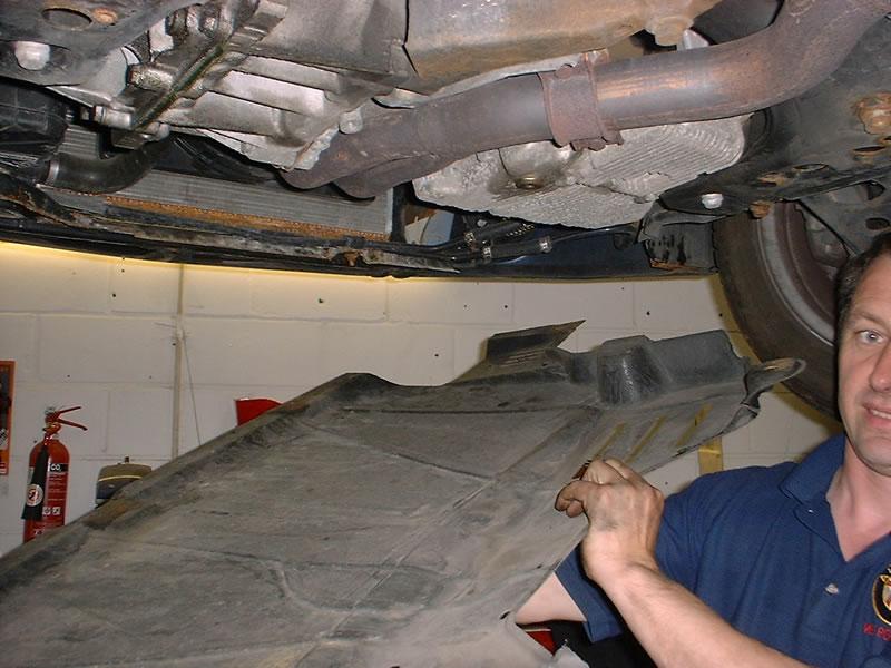

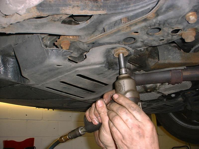

| Undo engine under tray and remove. |
| Ditto |

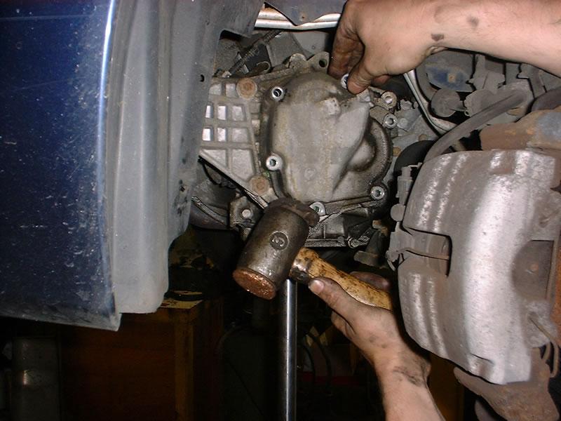

| Prop up the gear box so when you remove the end casing mounting bolts, the next gasket seal doesn |
| Undo the ‘gear box end casing’ bolts. |
| Tap casing with a soft hammer to loosen it. |
