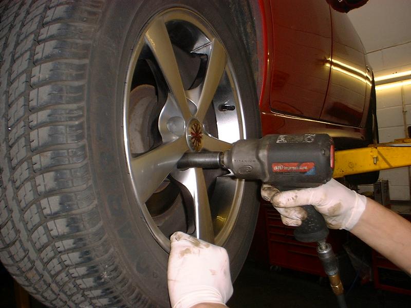

Remove road wheel

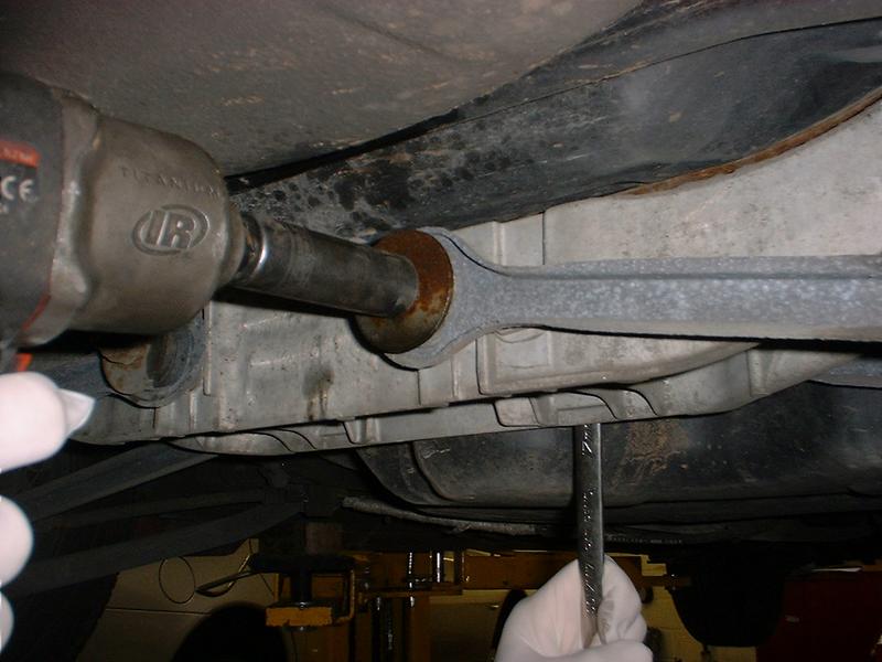

Mark position of washer on inner end of radius arm as this adjusts the tracking

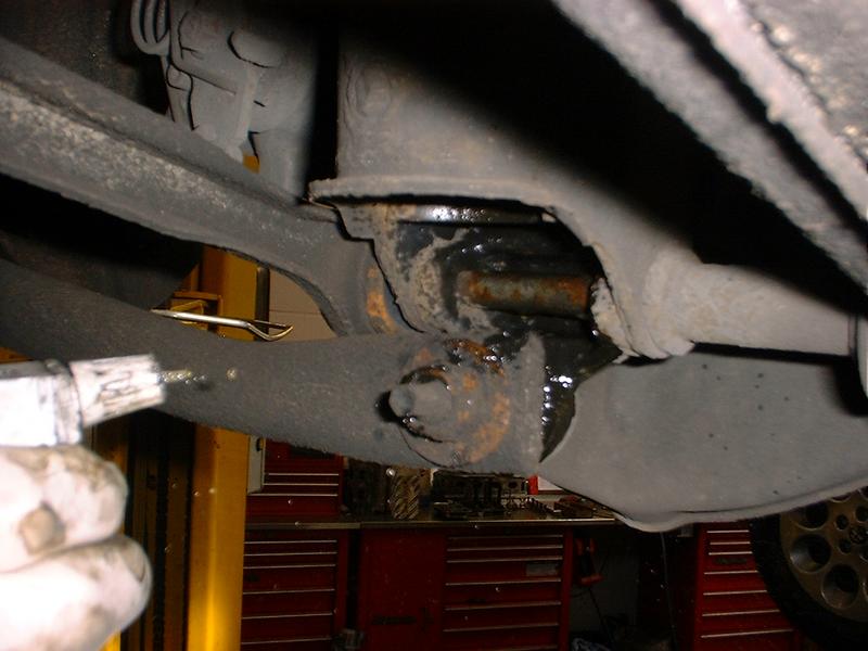

Lubricate all bolts to be undone
Alfa

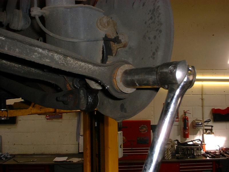

Undo outer securing bolt.
Tap
Free off outer securing bolt.
Using suitable drift tap out outer securing bolt.

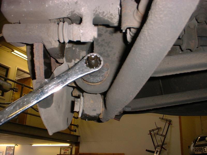

Undo inner securing nut while holding the bolt in position.
