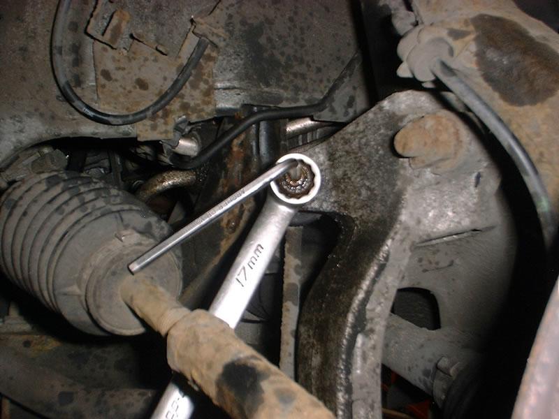

3. Unclip brake hose and remove roll bar link from the shock absorber with the aid of 17mm spanner and 5mm allen key. |

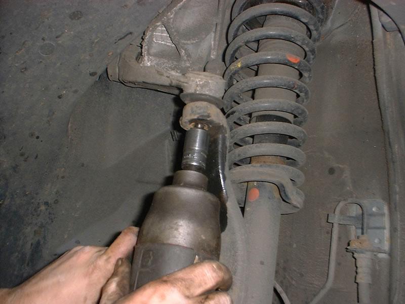

4. Undo wishbone bolt |

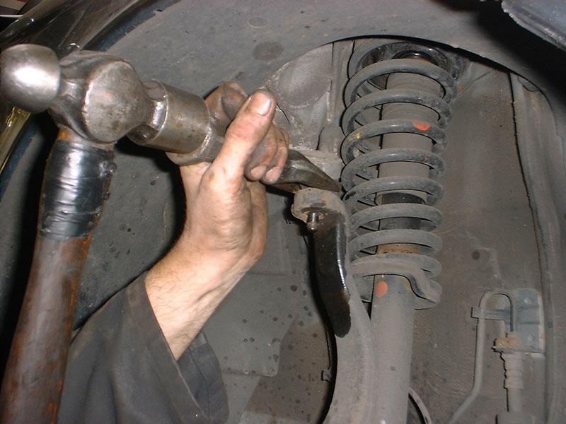

5. Split upper wishbone outer joint using correct tool. |

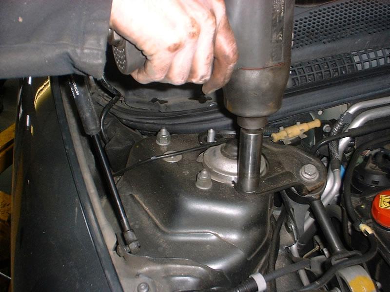

6. Undo the two inner bolts on the top mount of the shock absorber and tap bolts through. Pull shock absorber down. |
7. Undo the two outer bolts on the top mount which secures the upper wishbone mounting bracket. |

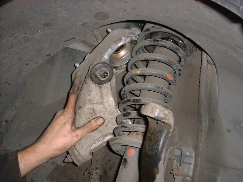

8. Ease the wishbone and mounting bracket out from above the shock absorber (it will come out honest). |
9. Undo the wishbone inner mounting bolt and replace wishbone. Refit in reverse order as above. |
